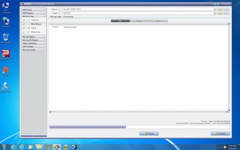

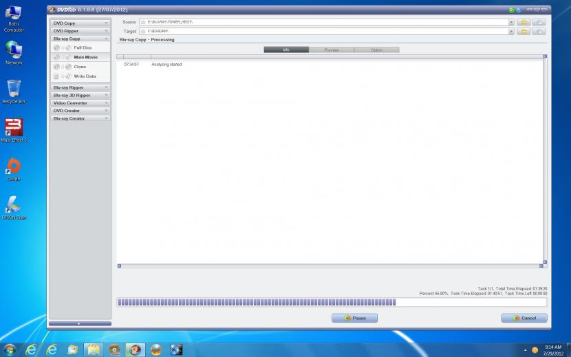

                    I am including the log file as well as a few screenshots showing
                    that one process took 1 hour and 40 minutes just to get to 65%...
