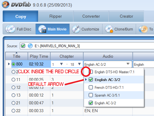

    Make sure that you select the correct audio in the audio drop down box, see pic
    CBR929

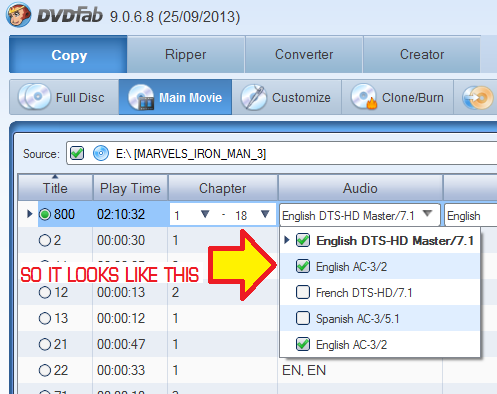

      Here you see the choice's for Iron Man 3 soundtracks the first audio track is DTS master this is the main audio track the ac-3 has the directors commentary in this case.
      If both are checked you get both and can switch between the two with your player.If you want only the DTS master just un check the other checked soundtrack.
      In Fabs software settings you can select all English soundtracks and Fab should check the DTS master first or if its hd dolby digital as long as you don't have remove HD audio checked in software settings or the pull down audio menu.

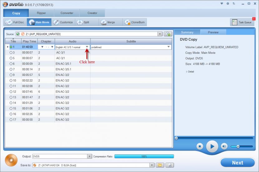

        Here is another screenshot using the copy program selecting main movie (I used the ripper program in the last screen shot) you click on the box under audio, highlight it and it will turn blue then you can use the pull down arrow to see what audio is on the disk and select your audio by checking the little box next to the soundtrack you want included in this example from Iron man 3 just the DTS master sound is checked so that's the only soundtrack that will copy over.

            You are correct. There is a problem in BD Copy with the placement of the default arrow in Main Movie. It makes the default play audio the AC-3/2 track or second English track in some cases, which can be a commentary or a visually-impaired stream. This began in v9.0.6.3 I think and should have been fixed by now. Full Disc should work correctly, but I have not tried it.
            Until this is corrected, you can take care of it manually by moving the default arrow to the correct (top) audio stream (the one with HD Master in most cases).
            See the attached screen captures.

                Putting a green check in the box will not make it default, you have to move the black arrowhead immediately to the left of the box you want to be the default audio.
