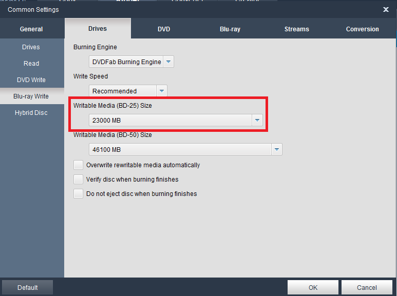

    If it is missing a little bit on the high side on compression you can go into common settings and cut it back a bit, maybe 22500 or even 22000.

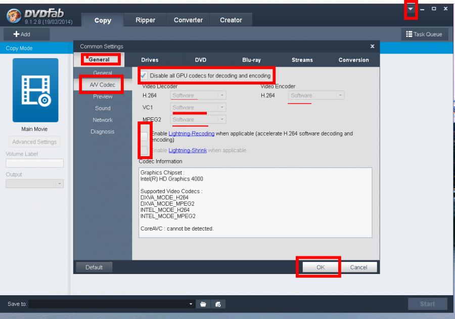

                          SPYDOR:
                          CUDA GPU acceleration for Lightning-Shrink enabled.
                          Go into Fab settings and check use all software and try again.
                          If you connect monitor to mother board you should be able to use quick sync
                          should be faster than the card with cuda.Fab doesn't support the later versions of cuda at this time.
                            Gimp:Read post#11 Better to light a candle than to curse the darkness.
                              Originally posted by glenns View Post
                              SPYDOR:
                              I turned off ALL GPU acceleration, as well as Lightning-Shrink. I did leave Lightning-Recording on by mistake though.
                              Got the same result.
                              I then plugged a monitor in to the on-board D-SUB, and got Intel Quick-Sync enabled (way faster than CUDA). I had both Lightning-Shrink and Lightning-Recording disabled.
                              Attached are both logs.
                              BTW, my 8.2.3.0 test worked fine.
