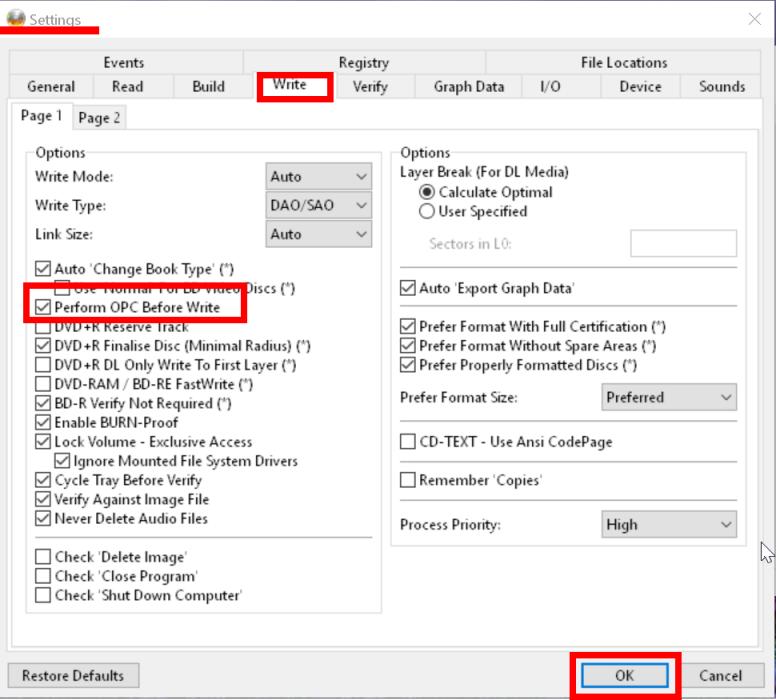

                        The perform OPC located in imgburn click tools - settings - write - page 1
                        Check (perform OPC before write) click ok.
                          No need to try with OPC off you already did that in the log file you posted that's why I said to turn it on and try again at 2x speed.

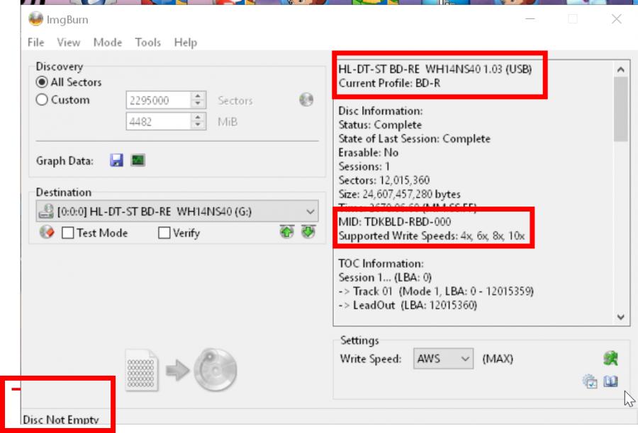

                            Img burn is professional burn software look at my screen shot using discovery Img burn will id the disk in drive by Manufacture.This is one of my Digistors disks in the drive it ID's Manufacture as TDK you can do the same to see what company really made the disks you have.These Digistor disks are 6x disks but you see img burn can really burn them faster at 10x with my disk burner a LG also show in this info.with model number and what version of Firmware it has on it.It also says there's already info. on the disk so its used already and has a movie on it.
                            In my experience any disk the professional burner software Imgburn says can burn faster than the speed marked on the disk is a disk that's made really well.Let's just hope digistor stays with TDK as manufacturer.I would buy just one if you can to preform this test and a burn with your drive or ask at the link I posted for them.
