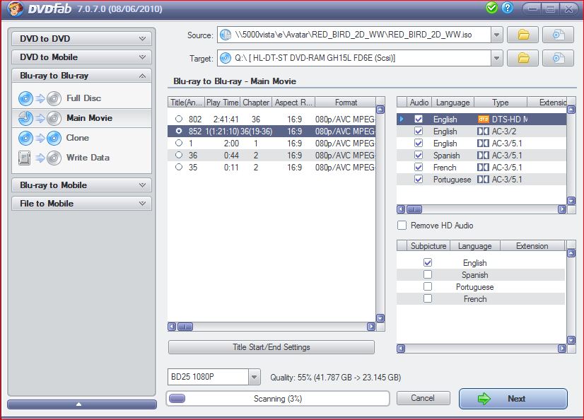

    I am having a problem with "Title Start/End".

    But on disks such as Avatar which shows as Format 1080p/AVC MPEG, the first output works fine but the second one attempts to compress the entire movie.

    Is there a way to correct this?

      Tried beta version 7.0.7.5, same results.
        Have you allowed the process to complete with Avatar to see if the files are about the right size?
          Attempted, but the process seemed to be stuck after 1.5 hours at 1-3%
            Follow up, it seems if I leave the credits off at the end the process works correctly. This worked on Avatar and Star Trek
