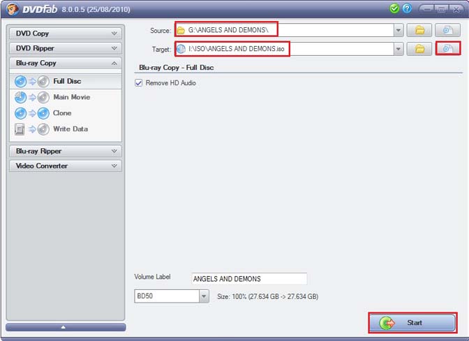

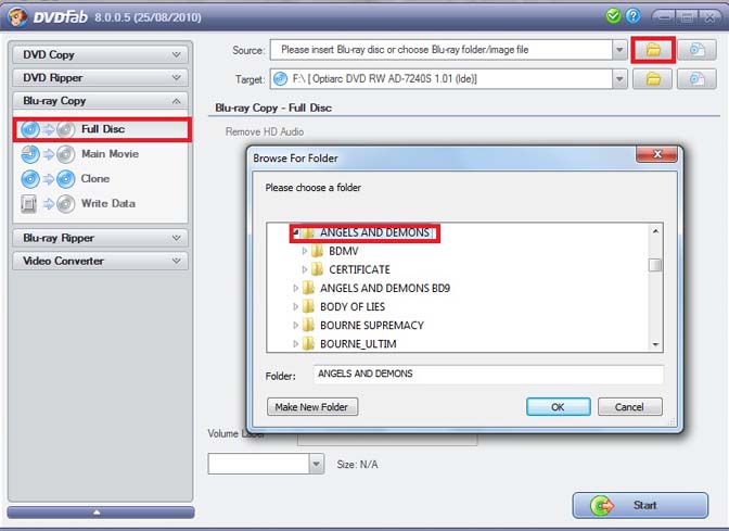

        Could you please provide a screenshot or two...like so:
        (You can see the selection process in screenshot #1...
        and in the #2 screenshot Fab opened the source files without issue)

        Below, I've selected a hdd as the target and also selected .ISO as the file format. Note the red outlined .ISO icon to the far right of the Target box (dog-eared page with the disc overlay).
        You can choose clone mode as sonydude1966 suggested and this will automatically rip in .ISO format, but will not give you any latitiude as to what's ripped.
        Essentially, clone mode will rip a 1:1, bit for bit copy.
        If that's what you want, great.
        The method I've displayed will allow you to rip Main Movie or Full Disc.

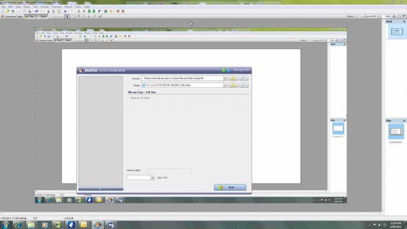

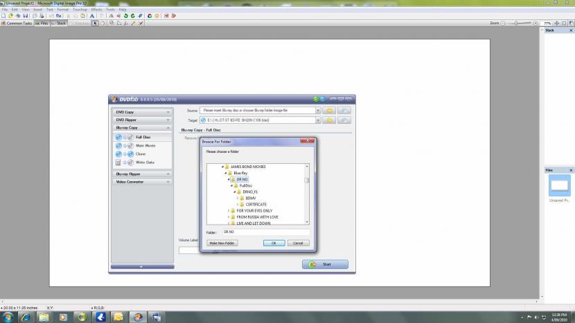

          Hi I have attached two screen shots. You can see I selected movie Dr No and selected Ok then see the next screen - nothing does not recognise it.
            Hi maineman postscript to my last post I have made it work. What it was is I had to click on movie file titled Dr No. I opened this to another folder called Full Disc. Then I opened it to another folder called DRNO_F1. The trick is to stop here and not open any further folders and select this one and it seems to load.

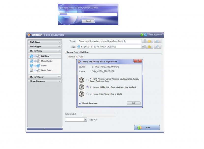

                I am getting so close to burning to blue ray now but am stuck on the last bit that seems to be a problem in DVDFab recognising the blank blue ray disc. It is a blank TDK BD - RE 50gb disc.
                Here are the steps I did and maybe you can tell me what is going wrong.

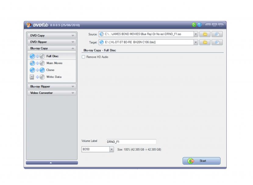

                When I open up DVDFab I select Full Disc mode and insert BD disc it says Open Blue Ray source. Then it asks me to specify the discs region code (see screen shot 1).

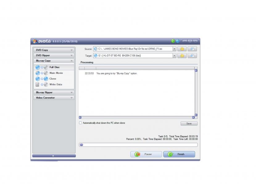

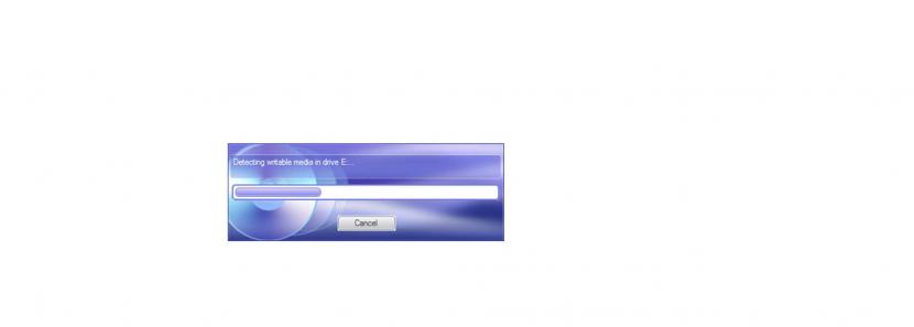

                After I do this I click on Start (see screenshot 2). Then I get a box saying detecting writable media in my drive. (refer screen shot 3). This goes on for two or three minutes then returns with the Pause Finish tabs at the bottom and nothing has happened (refer screen shot 4).

                    Now, to your never getting past the "detecting writable media" message.
                    Are you certain this TDK BE-RE is still writable?
                    Frankly I don't know much about BD-RE media and how many burns you can expect, but I've never been a fan of RW media for dvd video.
                    Not too bad for tv shows though, where expectations are fairly low.
                    Recommend that you give Img a whirl.
                    Click on the link in my sig
                    Setting Up ImgBurn and DVDab to work together
                    and download and install Img.
                    The link contains an excellent video tutorial on how to set it up.
                    Img is a much more reliable and configurable burn engine and is less likely to stumble with "difficult" or otherwise marginal media.
                    Hope this helps and doesn't further confuse the process for you

                      Thanks for your suggestion for ImgBurn. It worked first time perfect. This disc also works perfectly (to record onto this disc) with my stand alone Panasonic Blue Ray recorder. I suspect DVDFab has not been tested much if at all with dual layer (50 gb) rewritable blue Ray discs. Can we get a fix in DVDFab in future release to be more compatible with this type of disc?
                        Originally posted by LionelS View Post
                        Yes maineman I understand what you are saying.
                        Strictly speaking, the problem lies not with Fab, but with VSO... the default burn engine that comes bundled with Fab.
                        This is just one example why many users, and I believe all the mods, use Img.
                        VSO is problematic for many and Img is simply the best burn engine available, bar none.
                        You can suggest this fix to Fengtao (not part of VSO) or better, to VSO directly, but don't hold your breath.
