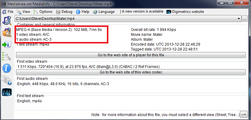

              Just noticed you selected ac-3 audio that's not in the audio spec. for the mp4 container so change it to something else like aac or same as source and retry.
                Check it out glenns, plays fine.

                    90312 Ok then they added this to the spec. as when it first came out ac3 was not in the spec. Sony didn't support it and it wouldn't play in any Sony products.I guess I am showing my age here.
                    SKOY: LPCM is not supported in this container so some concert movies only had uncompressed LCPM sound so check the sound track type on the disk with the concert on it.
