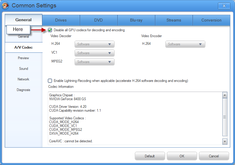

                      Another thing to try is using software only and no Cuda in Fab settings, note the time will jump up for conversion time but, the video quality might be much better.
                      You could do this over night while sleeping.

                        would u explain what u mean with this "using software only and no Cuda"?
                        sorry, I am so new to this conversion thing.

                              Hi skoy
                              If you do not understand and need help, that is what this forum is for, education and help.
                              Please read my friends post 18 again.
                              Here is some more info http://en.wikipedia.org/wiki/DVD_recordable and http://en.wikipedia.org/wiki/DVD-5#Capacity
                              You would change the settings in Fab here, see pic
                              Hope this helps
                              CBR929
