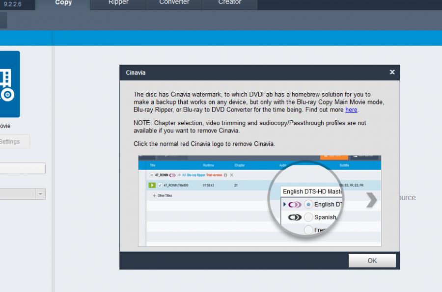

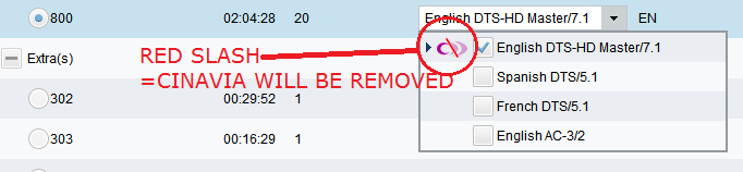

Of course not, the entire point of removing Cinavia is to prevent the muting and messages, your player will have nothing to trigger it. You should see the dialog box and other information as shown in the captures attached. If you don't see the red slash through the Cinavia logo, something is wrong.

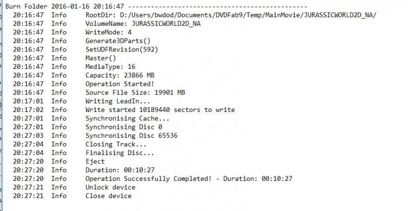

You have supplied the burn folder. I need the DVDFab internal log session from Jurassic World. See the link in my sig for instructions. The name of the file that contains the log session is "dvdfab_internal.log", which you can open and edit with Notepad to extract the needed log session. A log session begins with the DVDFab version number and date and ends with blank lines. The most recent ones are near the end of the log file.
That is indeed the correct log and it looks perfectly normal, but it does not appear to be the one where you actually processed the disc, so we can't tell where that one went wrong from reading this one. Do you have a Cinavia-enabled player (TMT6, PowerDVD15 etc.) on your PC?

It is possible you have a different version of the disc, please attach the dvdfab_internal.log per the instructions in my sig, below. Did your audio settings look like those in the capture below?
