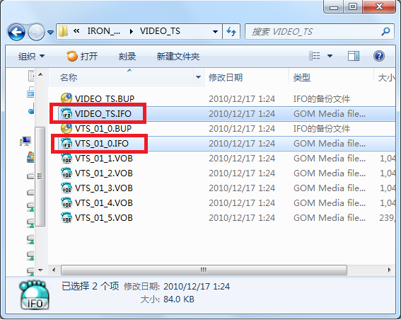

                  Hi:
                  Would you please attached two folder: "Video_TS.IFO" & "VTS_01_0.IFO". We can fix this issue if we got them.
