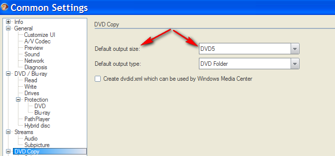

      Have you checked common settings to see if the default has changed.?
      See attachment.
        Yes, I have checked the common settings and it still shows as DVD9.
        This is why I have have said that the program interface has been forgetting the setting.
