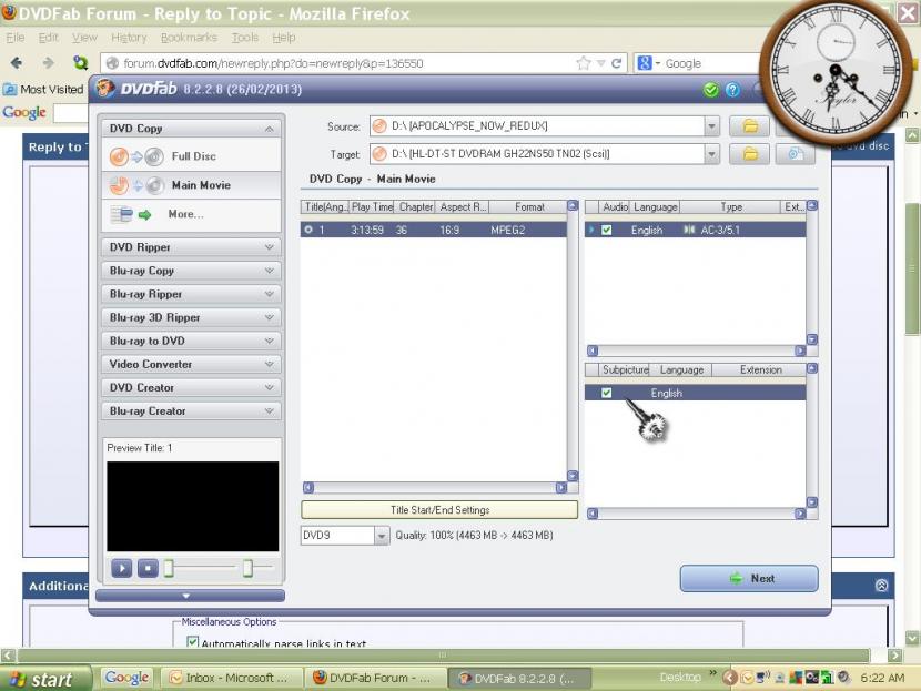

Is there some other setting in Dvd Fab?(see my attachment)

( I see in Dvd Fab under subpicture a box to be ticked? and an arrow to be selected? What should i do there)Attachment
What exactly is your expectation? Pop the disc in the player and subtitles start automatically?How to post the internal log

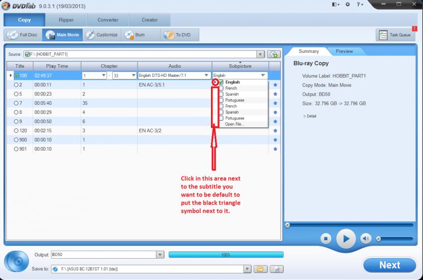

Said he was using Full Disc, but the screen cap is Main Movie. Needs to default arrow the sub stream to make them play automatically.Supplying DVDFab Logs in the Forum ...........................User Manual PDF for DVDFab v11................................ Guide: Using Images in Posts
