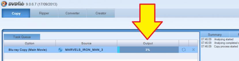

          Is there any way to see a progress bar ,like in DVDFAB8021 , to gauge the process of 9068 Beta, or any DVDFAB 9 program ?
            Bob
            The progress bar in v9 is up in the same area where all the titles are listed when the disc opens, see the attached capture. Click Finish before red X closing to make sure all settings are preserved and temp files deleted.
