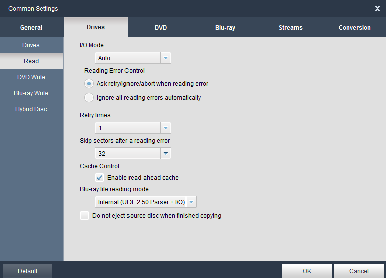

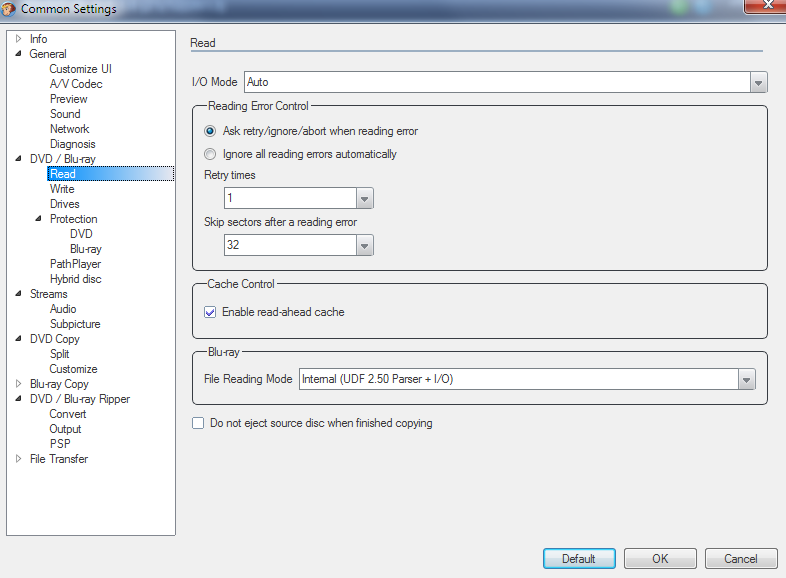

              You might check in common settings the read settings and compare version 8 to 9 and see if the I/O mode or something is different between the two:

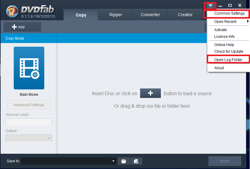

                    As I said in one of my earlier posts, I am embarrassed to admit that although I can find them on any version 8, I can't find the "log files" and "common settings" on version 9119. I see the "advanced settings" box, but nothing relevant to your query comes up.
                    Once again, the ver. 8. I bought works well, version 9119 is super slow & I cannot find a way to access common settings & logs.
                    Thank you very much, especially signals.
                      Find them here:
                        Are you serious?!! I thought that was the "eject disc" icon. Yeah, I feel stupid.
                        On ver. 8230 I/O shows "auto". On 9119 it shows the same.
                          You are of course welcome, but I should point out again that I can't duplicate this slow running, and you still have not posted a log or the text file output from ImgBurn->Tools->Filter driver Load Order, please do that.
                          You may also try:
                          1) In DVDFab Common Settings, set the I/O control to SPTI
                          2) Same place, UNcheck the read ahead cache.

                            In 9119 I changed both things you suggested & it did speed up, still not as fast as 8230 with the same movie. (14min versus 26min)
