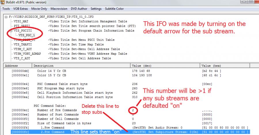

  • signals
    replied
    All
    Please do not bicker at each other about this issue, it helps no one. And do not further confuse the issue by using other software to process the content, the goal here is to see what DVDFab is doing and correct anything that is wrong.
    I have tried to duplicate the 'always plays subs' issue and I can't. If you have a burned disc or VIDEO_TS folder of a Main Movie rip that always plays subs that are not forced subs, please take the following steps:
    1) copy the VIDEO_TS.IFO and VTS_01_0.IFO files to a zip or rar file and attach them to a post.
    2) send me a PM to make sure I know they are here
    You can use DVDSubEdit (free) to see if the subs are forced. You can use IfoEdit or PGCEdit (both free) to see if the subs are playing by default and either of the IFO tools will let you modify the files so that the subs no longer play without user intervention (see attached capture). If you are aware of a way that subs can play automatically without defaulting them on or without a start command (forced subs), please enlighten us.
