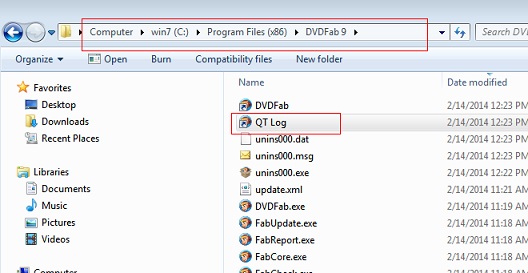

          If still has this issue, run QT log shortcut under fab install path.
          Then post internal log here.
