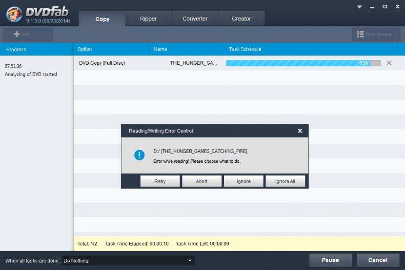

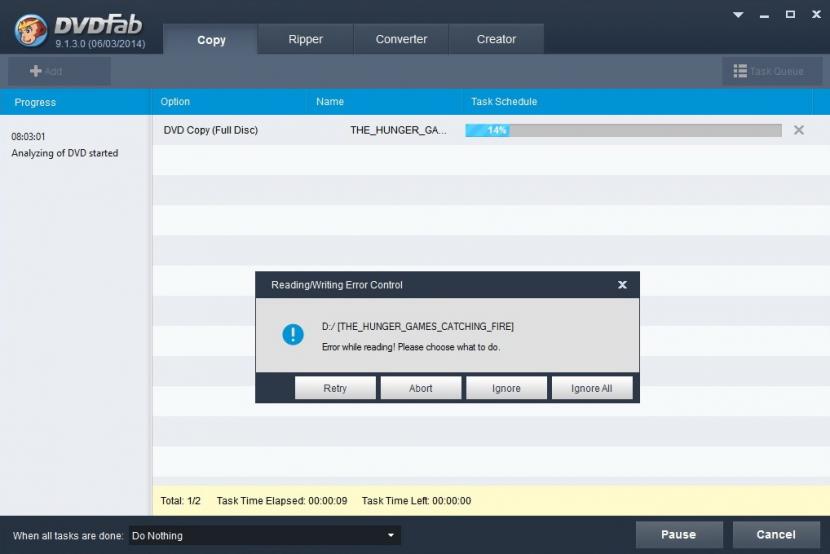

        Hunger Games, The-Catching Fire (2013) R1
        The Hunger Games-Catching Fire
        I,m having a problem with this title:
        I tried both Pathfinder Enable and Disabled.
        Region R1
        Image:
        1. Games, The-Catching Fire (2013) R1 [With Pathfinder Enabled]
        2. Hunger Games, The-Catching Fire (2013) R1 [With Pathfinder Disabled]
        Ty Kindly
        apollo13
          Just tried new software
          Still A prob here.

                      Hi apollo13,
                      Please post dvdfab_internal.log file, thanks.

                        Hi apollo13
                        0m 40.15s: read error: 0 29360128 1 199269 11682968 369909712 199269
                        If your receiving read errors, it may be a bad disc, have you checked the disc for scratches or even cleaning the disc may help.
                        If all else fails, take it back and get a new one.
                        CBR929
                          Many of the reead errors for this title are part of the protection. Note that v9.1.3.1 will be required.
