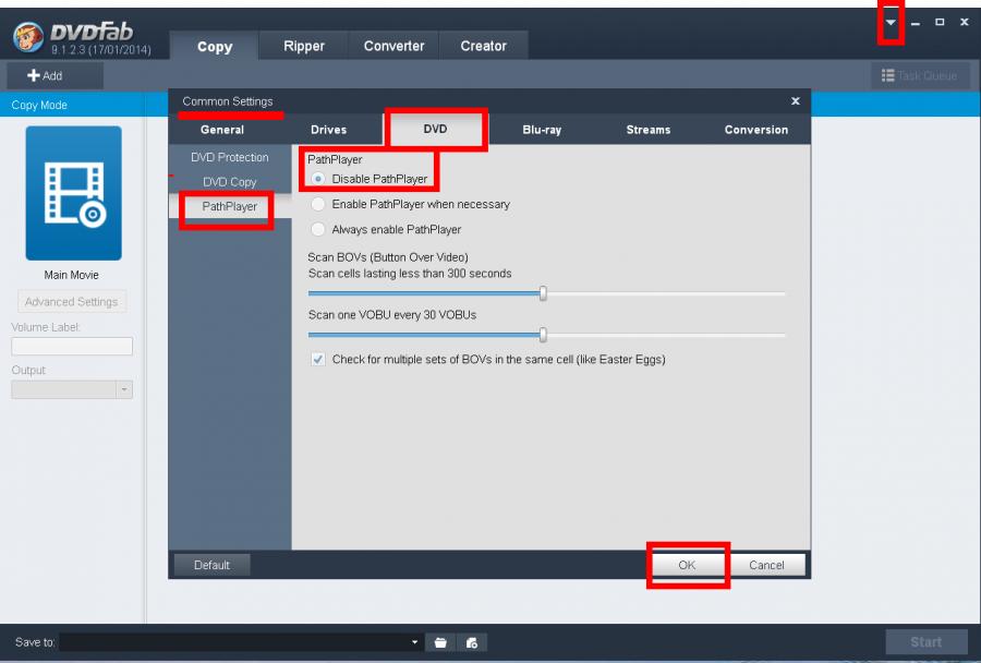

    What's important is if the whole movie is their with all the extra's as it could be dummy files on the disk that don't copy over.
    If the disk is not complete you can go into fab settings and turn off pathplayer then try again.Remember to turn it back on to always enable when done and check the contant before burning or storing.
