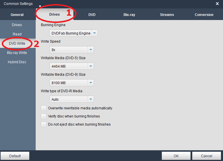

    I have campaigned for years to get the "Recommended" setting removed, it generally burns at the maximum speed supported by the drive firmware, which is not a good idea unless your drive is in pristine shape and you are using high-performance blank media. Try burning at 8X instead on single layer media.

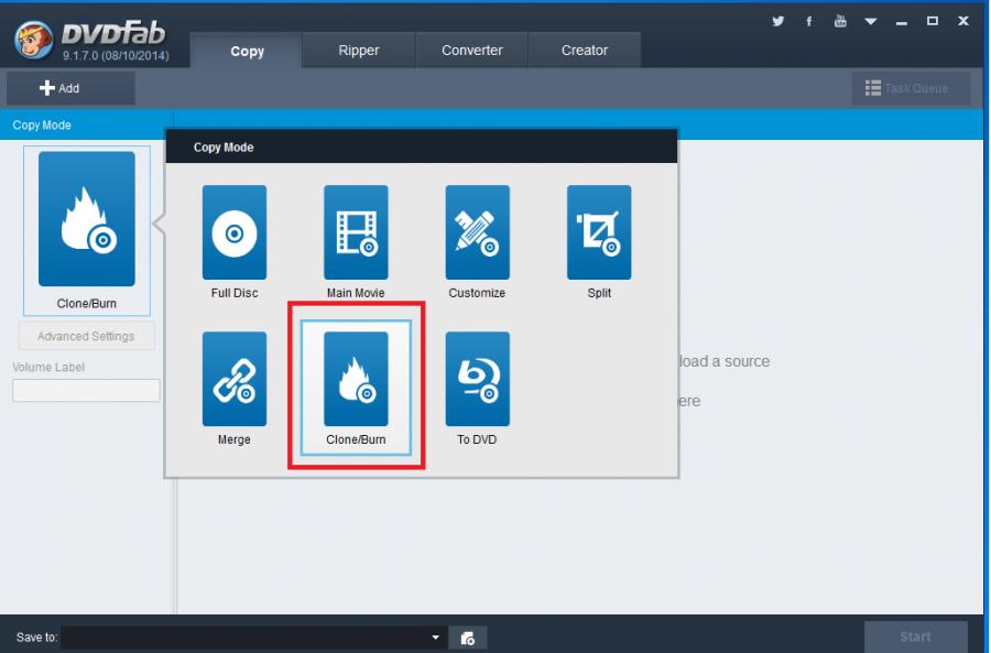

            If you are saving folders to the HDD you need to use Clone/Burn:

              You could also use ImgBurn as your burn engine you will find instructions in the link in my post on setting it up with Fab.

                DVDFab gives you many choices as my friends 90312 and CBR929 pointed out. I agree that ImgBurn is an excellent choice, but the DVDFab internal burning engine works pretty well, especially with DVD-5 single layer media.
                The log that would be helpful will depend on which burning engine you used for the burns that did not work. If you have the folders still for any of those, do as 90312 suggested and burn them to disc from DVDFab's Clone/Burn option after setting the burn speed to 8X instead of Recommended.

                  I could not find the ability to specify a recording engine
                  I could get here - Click Common Settings in the upper right corner
                  I didn't find an option to - Click the Write Tab under DVD / Blu-ray
