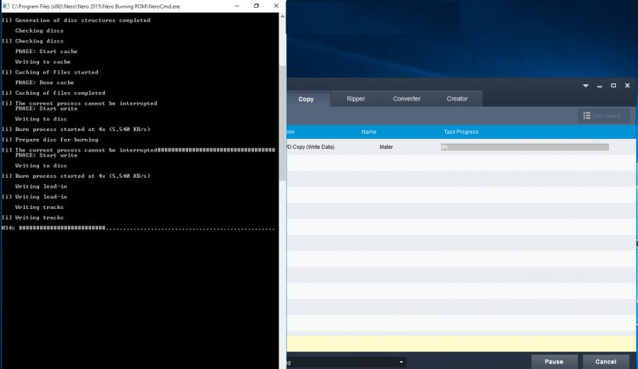

                        I can't reproduce the issue, running W10 and Nero. Tried burning one with Nero and it went off without issue.
