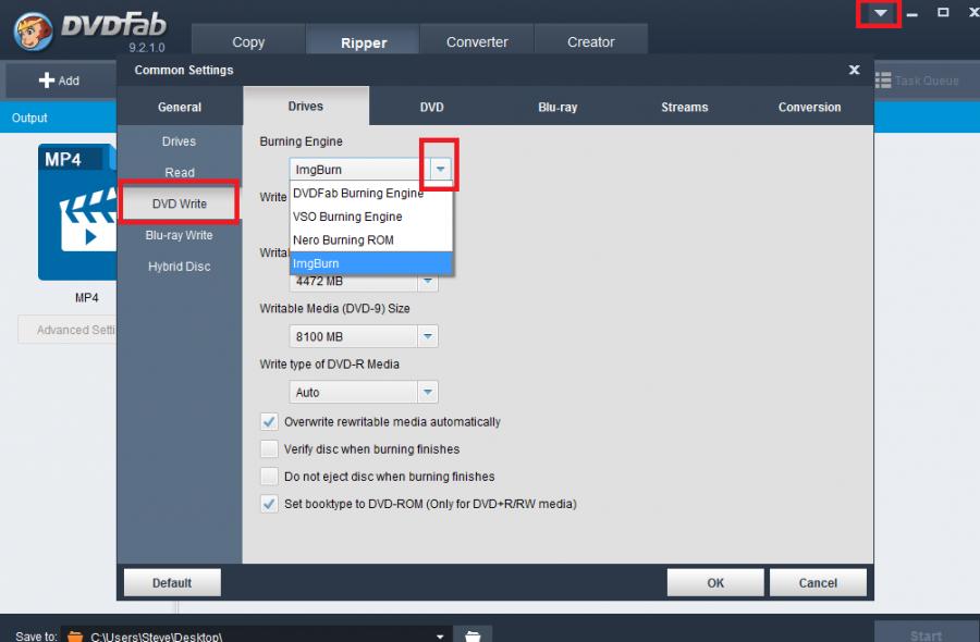

    Nero is still coming up in the burning options of DvdFab, after a complete uninstall of both products and a reinstall of DvdFab. Where does DvdFab get the information to create the list of installed burning programs?

      Do you have Nero installed?
      Not sure I made myself clear. That is indeed the list I am referring to. My question is how does DvdFab (from a programtic perspective on the backend (like is their a registry key used?)) compile that list.
      I ask, because my list has Nero in it as well, yet I have no Nero anywhere on my machine. Given Nero is in my list, I have to assume, I missed uninstalling some part of it.
      I'm compiling logs now to upload, but I really think this is just going to come back to Nero not being fully uninstalled, which is why that was my first question. Everything was working fine yesterday and for the past 6 months.
        Nero is installed as an option in Fab whether it is installed on your system or not. If it's not installed and it's selected you'll know!
            Well good, then maybe nero really is uninstalled.
