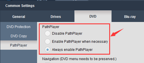

              I don't know what "PathPlayer" is.
              Help?

                Hi johntoste,
                Pathplayer is in "Common Settings -> DVD -> Pathplayer", please see attached screenshot.
                Regards,
                Mona

                  Success!
                  Thank you.
