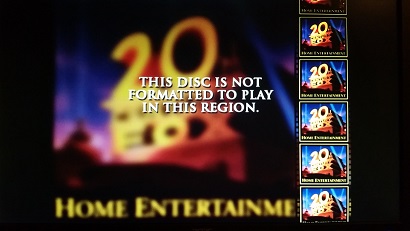

    Hello folks,
    This is an odd one for me, hopefully not so for you folks. The Martian DVD plays fine when inserted in to my computer so one would think it's a no big deal to back-up. It appears to copy OK, but then I get a message on my computer, after the burn, that states "This Disc Is Not Formatted To Play In This Region".
    The backed up disc won't play in my DVD player or on my computer.
    The original DVD of The Martian plays fine in my DVD player and on my computer.

    try slowing down your burn speed to 4x
      sb89052
      Your DVDFab internal log is incomplete, please try this again and follow the instructions linked in my sig, below. You do not need to supply the burn log again. Attach the log instead of putting it in the text window. If the discs you are using are marked "8X" on the blanks, try burning them at 6X instead if your drive supports it. The max speed is seldom productive for DVD-Video. The MKM-003 blanks actually produce fewer errors when burned above the minimum speed. You do not need to burn to disc again to produce the new internal log file, just write it to a HDD folder.
        Thank you, October262 and Signals.
        Your advice worked. I slowed down the write speed to 4x and got a perfect burn.
        Thanks again,
        Steve
