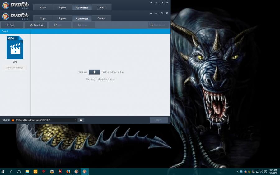

            What I have found is that after you install 9305 you must go to the install folder C:\Program Files (x86) DVDFab9 and rename it to DVDFab 9305 then install DVDFab 9306 going back to the install folder making sure that it is named correctly to the version of Fab you are installing. See pic

                    I installed 9.3.0.5 on a flash drive no icons, removed the flash drive then installed 9.3.0.6b on the HDD. Renamed the desktop icon to 9.0.3.6b. Popped the flash drive back in created the desktop icon and now both work.

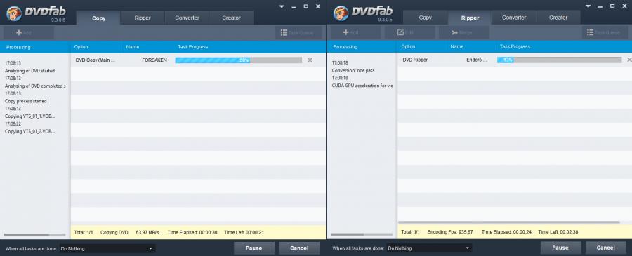

                            They will coexist and both function if you follow my instructions in my previous post. See attached:
                              They both function on my machine too, shown in my previous post pic
