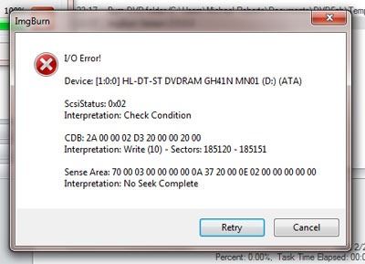

                        I think it might be an Lg drive. Maineman could you or anybody look at my post 31 and tell me what these are in his log files?
                            Howdy CB, looks like it's an Hitachi, but like you before I looked around, I thought LG too.
                            I'm no programmer and even attempting to read code is absolutely foreign to me...but those entries are essentially gibberish.

                              Maineman could this have something to do with his problem? I have posted this in another post
                              HTML Code:
                              I have seen this before while searching error code 400 and The path should consist of English letters Only to Temporary directory and Output directory!
                              . I know I found those characters in his volume label and they are not English could this be confusing Fab?
                                #30
                                HTML Code:
                                My guess is that the gibberish is the result of an error rather than the cause, but who knows?
                                The extent of my "code" work was configuring HIMEM.SYS in windoz 3.1 so I could play the original Wing Commander game...
