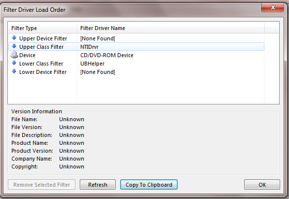

    I was just looking over your thread and I have another idea if you're up for more.
    I'm pretty sure it's down to a bad drive or corrupted registry files.
    Let's have a look at your upper and lower filters.
    Open Img > click on Tools > on the dropdown, click on Filter Driver Load Order...
    Post what you see.
    Maineman:
    I am up for more if you think there is a reasonable possibility that the drive is good. However, most of you guys seem to think it's garbage (defective and bad quality to begin with), so I don't know. I have attached a screen shot of the Filter Driver Load Order.
    I haven't made any of the adjustments you recommended yet as I wanted to see what you thought of the Filter info. Also, you mentioned Vista and I have Windows 7. Will these steps work with Windows 7?

      Hi Tad,
      Well, to be honest, I'm not a fan of your burner and I think it may have gone belly up, but hard to know for sure. Nothing personal here of course, but both DC and I found issues with this burner when we looked.
      Still, I think you shoud get rid of both NTIDrvr and UBhelper as both can cause problems from what I could determine.
      You can always reinstall them if they're essential for a program, but I've never heard of 'em.
      Sorry, I thought I read that you were using Vista.
      The win7 entry is actually listed before Vista
      Click on the microsoft link I posted previously follow the instructions on the MS site.
      You can also run the registry patch that I linked and this may work just as well...you'll have to try to see for sure. A word of caution though...I've never run the patch in win7 myself, but win7 has virtually the same architecture as Vista...or so I'm told by ppl. much more knowledgable than me.
      Still, I hate to recommend something to someone that I haven't tried.
      So I guess it's try at your own risk.

        Just did some digging of my own... not only is NTIDrvr a potential problem, but UBHelper is a piece of malware... OP would be well advised to run Malwarebytes on his system to get rid of that and anything else he has...

          I have removed NTIDrvr and UBhelper from the registry and ran malwarebytes and copied the log above. I even followed some of the other Microsoft recommendations and no change. Even if I get a disc to burn completely, they won't play. We get weird error messages from the DVD player, like "disc is dirty," or "cannot load disc." Consider this my concession speech.
