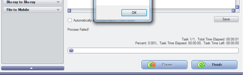

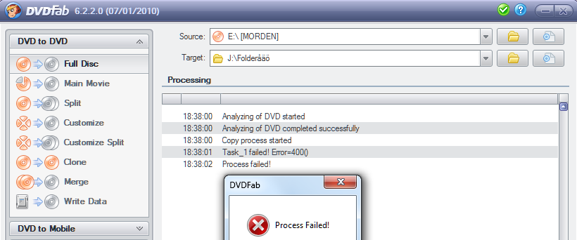

    If you create a folder with a name containing, in this case, Swedish characters, the program crashes.
    1. Create a folder named 'Folderåäö' and set it as target.
    2. Start the task.
    3. Crash and the program also creates a new folder named 'Folder___' on the hard disk with AUDIO_TS and VIDEO_TS folders, but empty.
    18:38:00: Analyzing of DVD started
    18:38:00: Analyzing of DVD completed successfully
    18:38:00: Copy process started
    18:38:01: Task_1 failed! Error=400()
    18:38:02: Process failed!

      Gummigutta I have seen this before while searching error code 400 and The path should consist of English letters Only to Temporary directory and Output directory!
        I think the program should take care of such things and it also seems to try to do it by creating the new 'Folder___'.
          Yes I know but awhile ago while searching error code 400 I ran across that it confuses Fab so you will get this error.
            Change the Windoz default language to Swedish, and it'll work fine...but make sure all your other folders are in Swedish, too, first...
            Windoz verifies all letters against the default language alphabet, and any it doesn't find are treated as 'illegal characters'...
