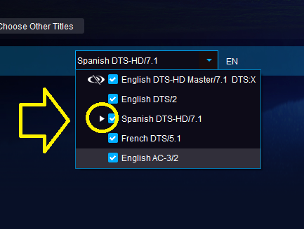

    2) On the Copy setup page, make sure to select the stream that you want to always play by default by clicking to place the small white arrow next to it as shown in the capture.
