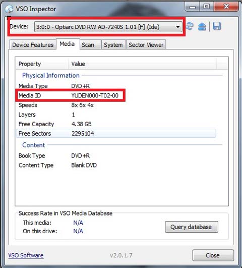

                        Please download and run
                        VSO Inspector
                        and post a screeshot.
                        It's free, safe and deveoped by VSO...the same folks who author VSO, Fab's default burn engine.
                        It will ID your burner and MID like so:
                        It's useful to obtain other info too.

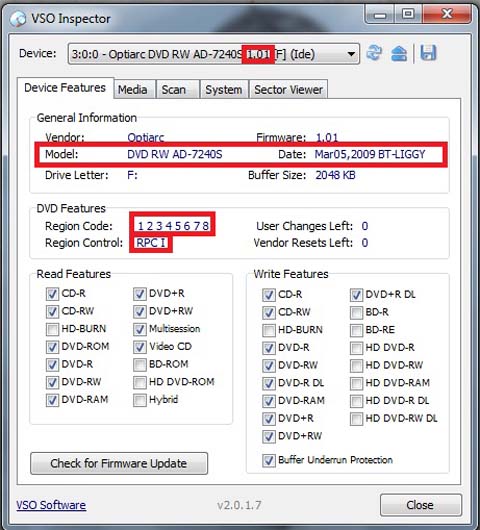

                        For eg., you can see on the next screenshot that this burner was flashed with Liggy and Dee's modified firmware to provide bitsetting and rpc1 (region-free coding):
