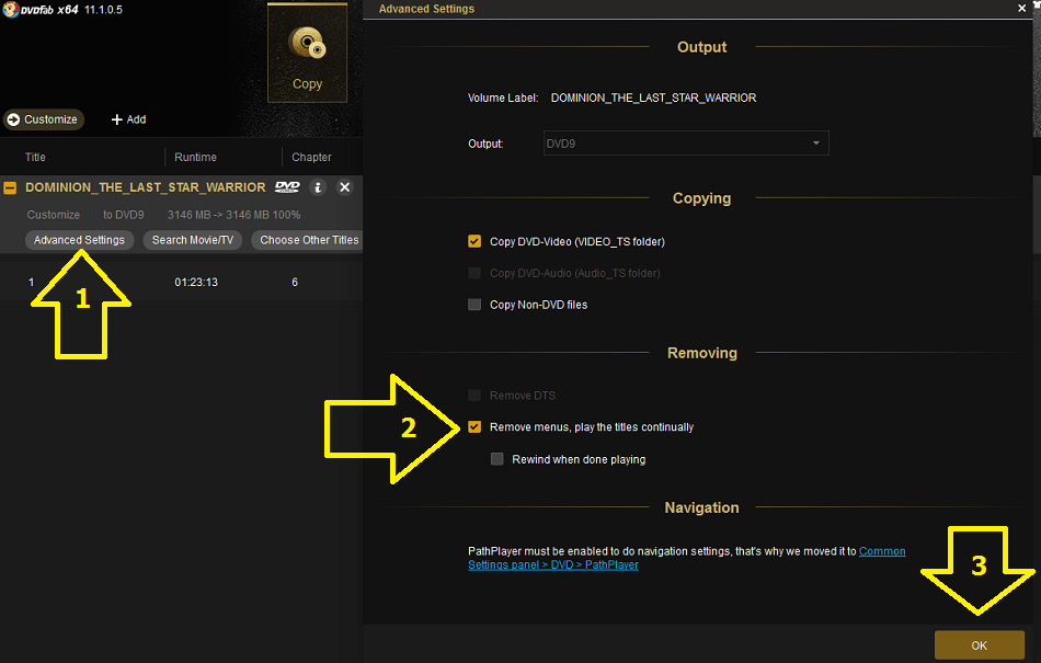

    Load your disc into DVDFab, select Copy and then Customize. Then follow the steps shown in the capture. You really should read the pdf of the DVDFab Manual, it is linked in my sig, below. You make lots of posts for things that are clearly explained there.

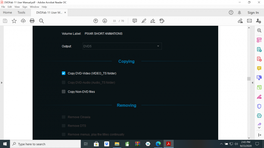

      I did read the manual and I did go to the screen you showed above. There was nothing there for "REMOVING". That is why I posted here.
        Here is a screen shot.
Name:	DVDFab Copy Advanced Settings.png

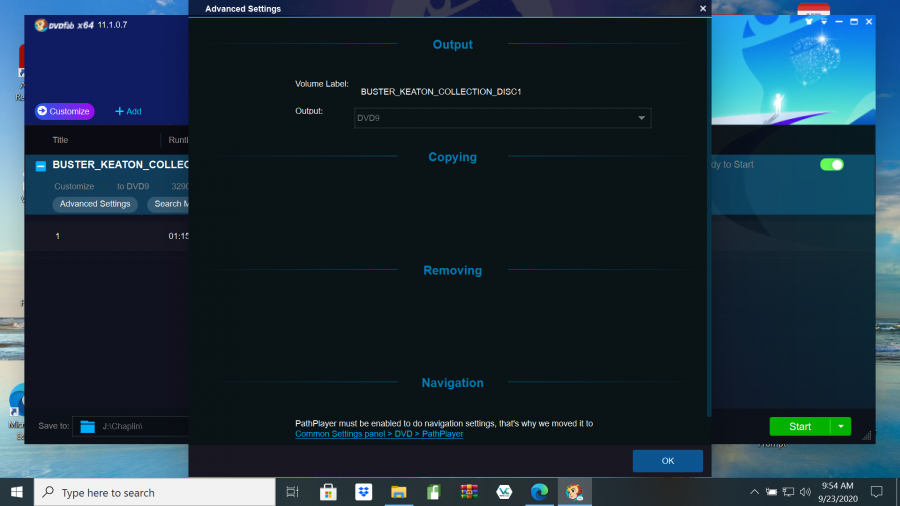

          Here is another screen shot from a different DVD. There is nothing there for Copying or Removing. So please be patient with me. Thank you.

            My Advanced Settings Screen does not look like this
            This is what mine looks like,
            There is definitely something wrong with this screen on my computer. I would appreciate some help on this. Thanks in advance.
              Is it because the screen resolution of my current laptop is 1920 x 1080? I have an older computer where the screen resolution is 1366 x 768 and the advanced settings screen is correct. But my older computer is no longer supported. I would like everything to be 100% on my current laptop. Any issues with 1920 x 1080 that you are aware of?
                I solved the problem. It had to do with the DPI scaling which for my computer is 150%. I was able to go into the properties > compatibility and override the high DPI scaling behavior where the scaling was performed by the system. Now I can view and modify the Advanced Settings screen properly when in DVDCopy > Customize.
