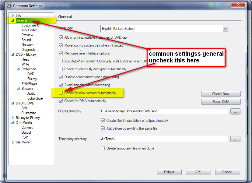

        in common settings- general of DVDFab make sure (check for new version automatically) is not selected

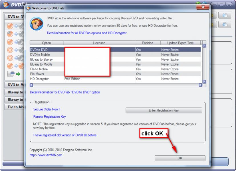

            When I click on the icon I got after installing the 3/26/10 down-load, here's the initial message on the screen that comes up:
            Welcome to DVDFab.
            You can use any registered option, or try any option 30 days for free, or use HD Decrypter for free.
            Below this are the lines that can be hi-lited for which option to use. There is no "general tab" or anywhere else for common settings. So I still cannot make this work.

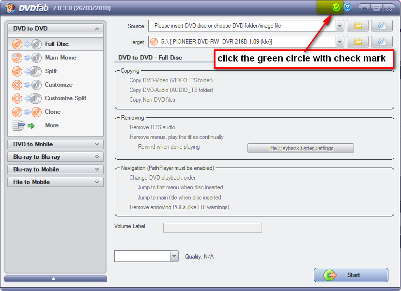

              Tom click on the green check at the top of your screen and click on General settings,,,,,
                There isn't any "green check" at the top of my screen. The first line, as I described in an earlier post, is a blue line that says "Welcome to DVDFab" and has the "X" to exit at the right side of the line. By the way, there are a couple other posts today that seem to indicate the same problem I'm having.
                  You are describing the splash screen. The green circle with the white checkmark is in the same place in the program main window. Clicking it will access the Settings menu and allow you to turn off checking for new versions. Click on the "Start DVDFab" button in the lower right to start the program.
                    Check out the screen captures I attached to know what to do

                          My "splash screen" is similar ... but says "Start DVDFab" instead of "OK" in the bottom right of the screen. But when I click on it, the program exits. I never get to the screens you posted.
                            Your splash screen looks just like mine. It disappears when you click Start DVDFab, but the main screen should open in about 4-5 seconds. Did you run the installer "As Administrator"?
