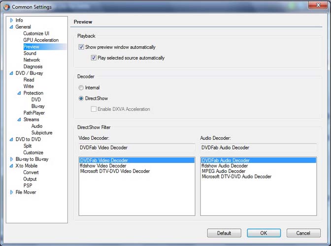

                hi maineman..ive downloaded ffdshow could u please inform how to setup..thre are various pages? i would like to use it to make preview work in plain dvd to dvd mode..no blue ray !
                Hopefully, you shouldn't have to do anything.
                I had ffdshow on my older rig and I just installed it on my win 7 rig.
                Just download the latest version, install and let the app load the default settings.
                Here's a screenshot
                The preview function worked like a charm with the Fab defaults and with ffdshow
                    Here's a screenshot
