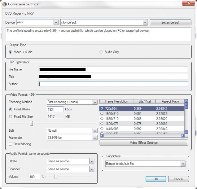

      These are the settings:
      With this Quick Sync Works. As soon as I change it to 2-pass with same settings it uses the software encoder (cpu).
