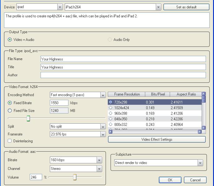

                      Here is the recipe that works for me:
                        I see a few difference:
                        1) Audio - you are encoding at 160 kbps vs. me at 96. I assume you do this manually by bumping it up?
                        2) I have the same frame resolution but your bits/pixel are twice mine. I'm at .150 and you are at .301. I ripped mine from an uncompressed ISO so I'm not sure why the difference.
                        3) Then, of course the bitrate/file size - but that would have all to do with #2.
                          1. yes a manual change.
                          2. I always bump the bit rate until the bits per pixel is grater than .2, a bit rate of 1500-1800 will usually work fine to get good color depth.
                          3. the file size is determined by bit rate and frame resolution. It is what it is.
