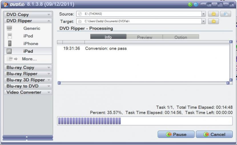

conversion hangs/freezes
    DVD Ripper conversion hangs/freezes
    -- using current ver 8.1.3.8
    -- dvdfab_process log file doesn't provide any error code or cause.
    -- dvdfab_internal log file provides the following:
    ------ begin mobile work(1/1) ------
    19m 08.27s: info: create config(0)
    19m 08.27s: info: convert profile(iPad.h264)
    19m 08.29s: info: dvd playlist(10),angle(0),chapter(1->12),3D(0)
    19m 08.29s: info: streams((480.2)(131.2))
    19m 12.45s: info: not set correct fourcc for video(28)
    19m 12.45s: info: set output video frame_rate(30000/1001)
    19m 13.70s: info: h264_encode: encode param profile(0) level(30) bitrate(1308)
    -- encoding fps increases for several minutes, then starts descreasing until it hangs, usually at the same percent complete. see attached file.
    Please advise.
    I have the same issue. The task timer keeps counting up, but the task time left says Zero. If you press the options or preview tab, it says no re-encoding is going on.
    Seems to be a bug in the software? I was able to successful rip one movie, except accidentally ripped it with subtitles. Trying to rip same movie again without subtitles and now it just continuously hangs.
    It will start encoding fine, then slow down the FPS encoding and then it stops displaying the FPS and just sits there.
