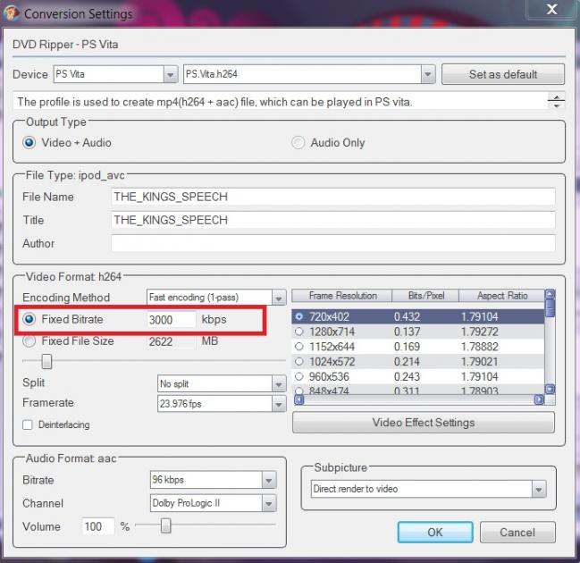

    Anyone can show me how to set the bitrate higher on PS Vita Profile?
    I have asked in another post before, I manually edited the profile and I was told to set using the profile editor. I did both but the result is still not able to achieve over 1300kbps.
    Thank you very much
    I just used the existing profile and was able to set the bit rate, what am I missing? See attached:

          The bit/pixel is the product of the encoding bit rate. Increase the fixed bit rate (in the box to the left) until the bit/pixel is the value you want.

              Why are you using the profile editor? Just use the included profile in the Ripper and edit that by pressing the edit button. You don't need the profile editor.
                Do you mean the Conversion Settings (the photo I attached before)?
                Under Video Format: h264, the (MAX) Fixed Bitrate is somehow set to 768kpbs and won't let me set it any higher?!
                From here, I was told to try to use the Profile Editor to change the bits/pixel but failed. I even manually change the xml file before I reinstall windows but never get what I was hoping for.
                  I'll try one more time. The advice was given you before they included A PS VITA profile in Blu-Ray Ripper. You do not need Profile Editor. Just open the Ripper and select the profile from the drop down list, I think it is under "more" Select your movie to convert and click the edit button down at the bottom of the screen. In the fixed bit rate box you can increase it until you get the bit/pixel you want.

                    The profile limits the bitrate in the case of the PS Vita:
                    <bitrate value="640" min="1" max="768"/>
                    It is set this way to correspond to the available frame sizes offered in the profile, none of which would require the high bitrate you are requesting. You can manually edit the profile with Notepad to change the max setting, but it shouldn't be necessary and the device may reject the file.
