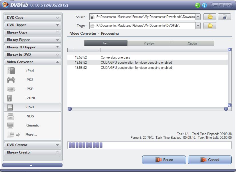

              When the fps rate starts dropping, the conversion has crashed. You can monitor this using the process preview window (middle tab). The image will freeze when it crashes in most cases. One common cause of this (in DVD Ripper) is related to the authoring of the DVD, for which the older versions (8.0.7.3 and 8.0.8.5) provide a workaround--this is why you were offered their use as a possible solution. This is probably also related to the source content in some way, but it is impossible for the developers to test the exact files you are using. Post internal logs and MediaInfo scans of the source files when one fails to convert.

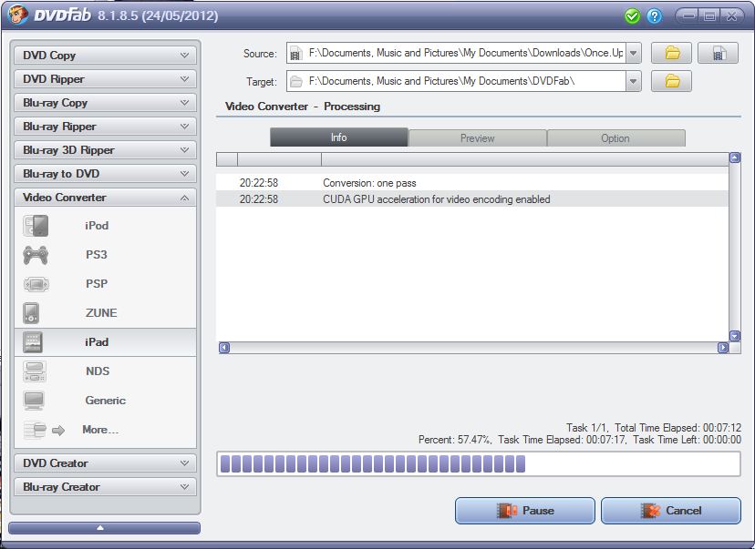

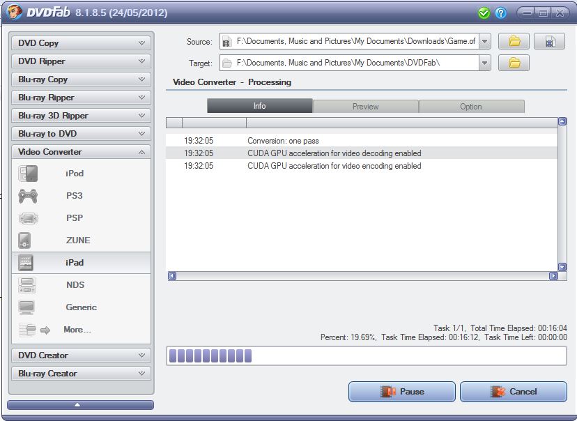

                signals: attached are what you requested, I think. If it's not, let me know and I'll try again. It include the internal log (I included the whole thing which looks like it started when I first installed DVDFab v6). I tried to convert 3 separate files (TS, MKV, and AVI), and dropped to zero fps each time. I've also included relevant MediaInfo scans and screenshots from each. Had to split the reply into two posts due to limits on number of attachments.
