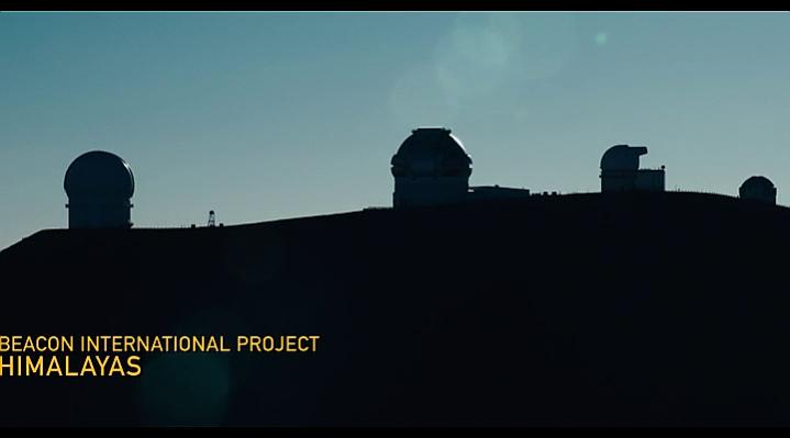

    I just tried this and it works fine for me, maybe it is your settings. To make the cropping work correctly, you must select Customized Size on the Resize tab, then type in the output frame size that you want and click the Add button. Then on the Crop tab, select Keep aspect ratio and use the black bars slider to crop the image. The second attachment is a screen capture from VLC media player of the result.

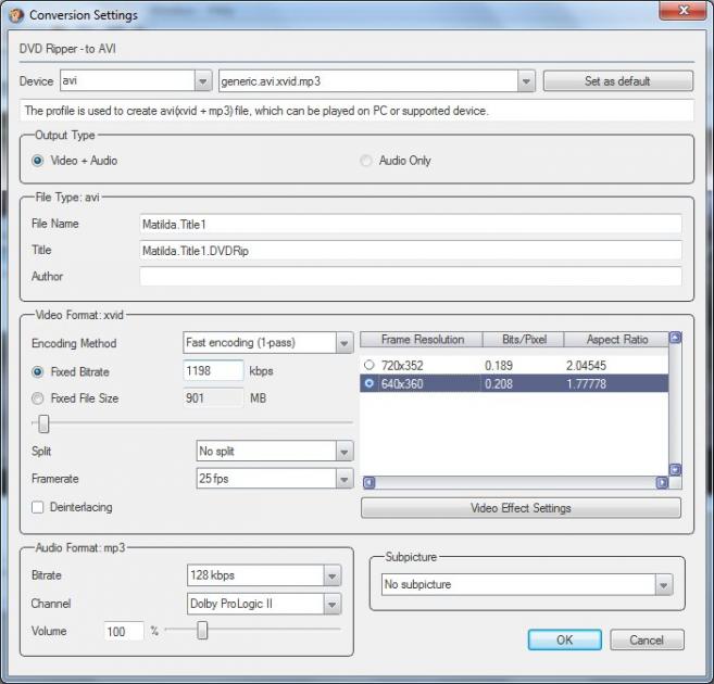

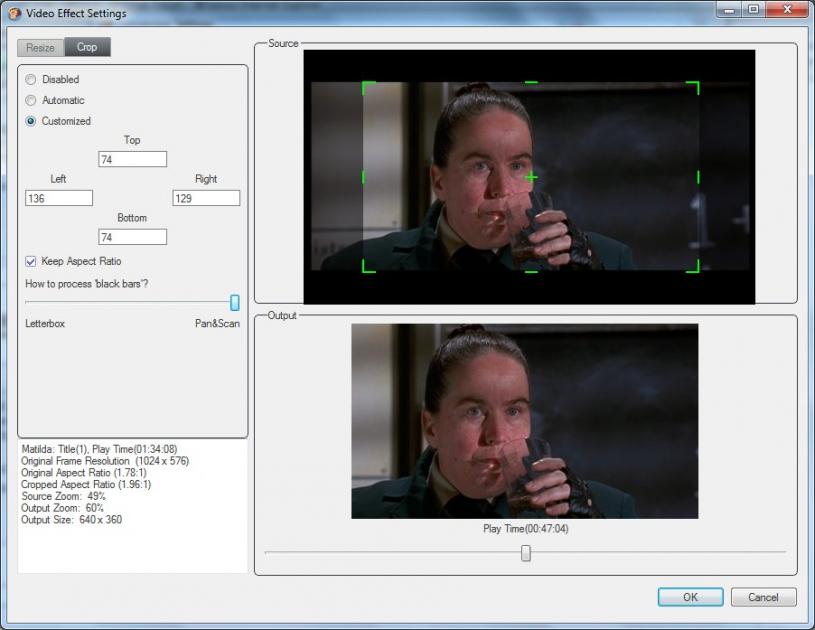

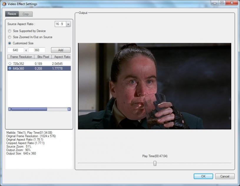

      Hi thanks for that but I have done all those things before. This time I have attached some screenshots that show the settings are correct but the output is 640x360 with borders exactly the same as the original
