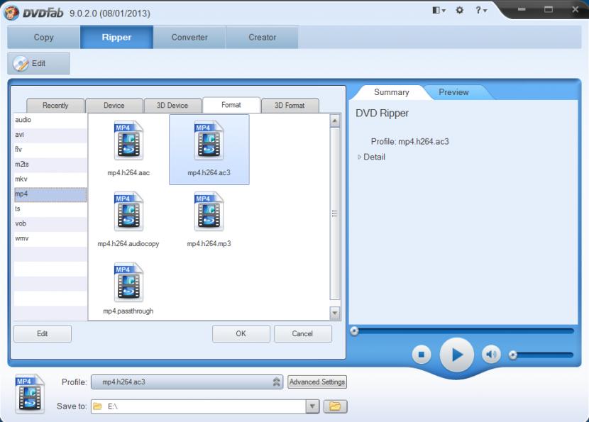

          Why not try the mp4.h264.ac3 profile under the mp4 format selection.
            I don't have an Apple TV but try this profile, might work without all the extra steps:
