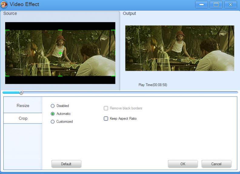

    It must be the profile you are using. I just tried a DVD and a BD that were 2.37:1 and both were cropped with no black bars, i.e. the source aspect ratio was duplicated in the output with automatic cropping selected. Some profiles have fixed output sizes and aspects, not sure if that is what you are seeing.
    This was with v9.0.3.8, capture attached.

            If a bug of opening Video effect page in DVD ripper. Do not repro in BD ripper. The frame resolution for DVD will change to another after opening the video effect page. We'll fix it asap.
              Terry I apologize.... This is actually an issue on BD Ripper, even though I accidentally tagged it as DVD Ripper
                Yes, I got it. It's another issue about do not select the cropped frame resolution in Resize table. We'll fix it asap.
