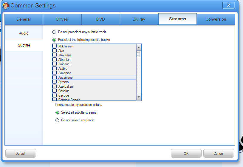

    You can set it in Common Settings->Streams->Subtitles.
      Thanks, terry5, for getting back to me on this.
      I've looked at the Common Settings>Streams>Subtitles options but I read them as turning on or off all subtitles, not just the subtitles for the non-English dialog. Perhaps the BD I'm ripping has embedded subtitles for these sections - it's just that I don't know how to find out.
      I'll try ripping with subtitles ON, but in my player turn them OFF except for embedded ones. I've tried the reverse - subtitles disabled - and find I get no embedded ones.

        I've tried various settings for Common Settings>Streams>Subtitles and I get exactly the same result - all subtitle dialogs with EN selected under Subtitle on the Ripper screen, or no subtitle dialogs at all with EN deselected.

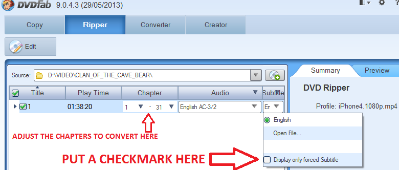

          I think there is a problem here with terminology. What I think you are asking for is a way to have the translation subtitles ONLY included when converting a movie using the Ripper module. DVDFab has a way to do this which works with most discs: it is the "Display only forced subtitles" option. In v8 it is a checkbox just below the subtitle stream selection window, in v9 it can be enabled in the subtitle dropdown (see screen captue) or an "always do this" checkbox in Common Settings. Most translation subs use forced start to be displayed, so DVDFab can filter the single stream you select to include only the translations. If you select 'Display only forced..' and there are no forced subs in the stream, you will get no subs at all. If you select a stream and do not filter it with 'Display only fored..' you will get all of the subtitles in the stream (which is what you describe).
          Note that there are many different ways to accomplish this in DVD/BD authoring, and each disc seems to use a slightly different approach. Some recent Blu-rays do not use sub streams for translations at all, they are burned into the video.
          A good approach to save time is to locate a chapter in the movie that you are sure has translations and convert only that chapter using 'Display only' and see if you get what you want.
