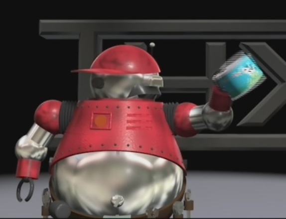

        Some pictures
        Just thought I'd check in to see if this has been addressed. Here are some examples from the THX trailer (note that I have seen this same behavior on other "TV cartoons" on DVD as well (Dilbert, Dr. Katz). I've tried converting to xvid avi and WMV with the same results. I've also tried several different resolutions and bit rates (the same issue occurs both with high resolutions and bit rates).
        The attachments are cropped to a selection that shows the issue.
        This is what it looks like with Deinterlacing turned on. Jaggy. This doesn't change (nor does the file size change) regardless of deinterlacing mode chosen in the custom profile.
        This is what it looks like with Deinterlacing turned off. No longer jaggy, but highly visible horizontal line motion artifacts.
        This is from another conversion program that doesn't have either issue.
        Please advise. Thanks.
