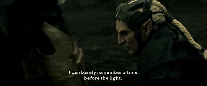

                      Please share your results. I have attached a capture of some of the translation subs from a test MP4 I made.

                        Just ripped it. The alien subtitles came through perfectly. Thanks for your help in resolving this.
