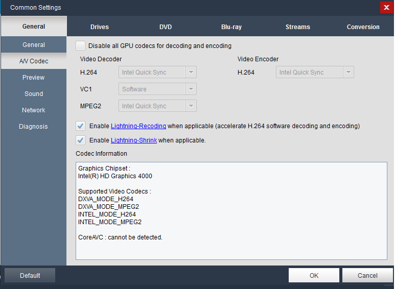

    have an Intel i3 3140 with a mainboard H87 chipset.
    This is an Intel HD 4400 GPU.
    Up to the 9.1.2.9 version everything was OK
    9.1.3.1 can't
    9.1.3.3 can't
    9.1.3.5 can't
    Video chipset:Note: to enable Intel Quick Sync technology, you must switch to Intel HD graphics.
    Intel(R) HD graphics 4400
    Supported video codecs:
    DXVA_MODE_H264
    DXVA_MODE_MPEG2
    CoreAVC: is not recognized.

                    Oh, this maybe my problem , I think I just downloaded that version of the Intel driver and I can't get IQS working anymore. What is the last 'known' Intel HD Graphics driver known to be working with DVDFab & IQS?
                      Yep fixed it ... downgraded Intel HD graphics driver to the January 2014 version, 3412 (v15.33.13.3412) and Intel Quick Sync is running fine again. Definately would not work on the latest Intel driver mentioned earlier in this post.

                        There is a fix in v9.1.3.7 Beta, please try it and report your results with the newer Intel driver.
