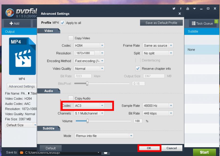

            Change AAC sound to dolby digital AC-3 sound in advanced settings this will make it work.I assume you know this disk has Cinavia on it so if you make a disk you need to play it on a uninfected by Cinavia player or on a media player or use a uninfected softwear player if on computer or the audio will mute 20 mins into the movie.

              So do I change,
              codec which is on AAC to AC3 / MP3
              or
              Channels which is on 5.1 muti to Dolby surround pro / Dolby Pro Logic 2
                  I have tried above suggestions and a few alternatives and even tried not converting the sound by ticking copy audio but still no joy.
