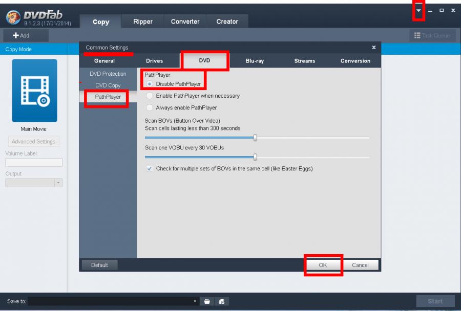

      Disable Pathplayer
      Go into the dvd settings by clicking the downwards pointing triangle. Disable Pathplayer. That does the trick. I just tried it after not noticing a reply to my Farley disc question. Thanks Winston!!!
        That's Wilson not winston.
        When you turn off Pathplayer make sure the movie plays back ok before you burn it and then go back into settings when done and set it back to always enable pathplayer.

            They have tried several solutions, but TV discs cause a problem for PathPlayer because the many episodes of the exact same length mimic a disc with a certain type of structural protection. They never give up. For now, the best idea is to turn off PathPlayer, but be sure to set it back to Always Enable for theatrical discs and check the TV disc content before burning as glenns suggested.

                    Yes, with PathPlayer disabled it works ...
