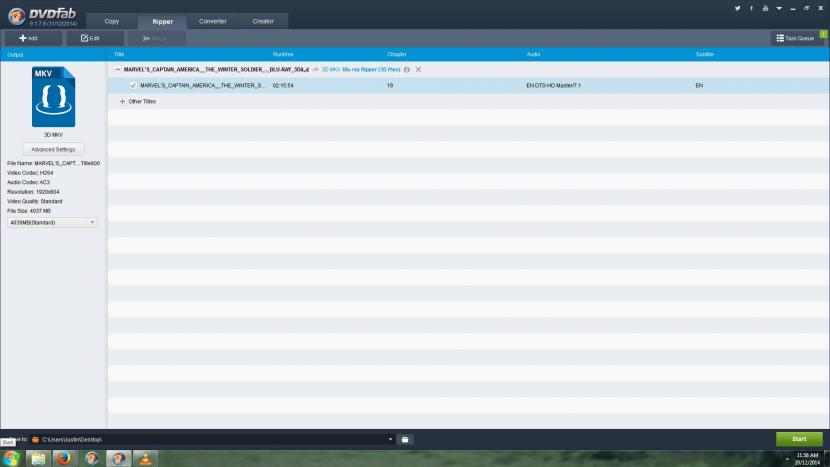

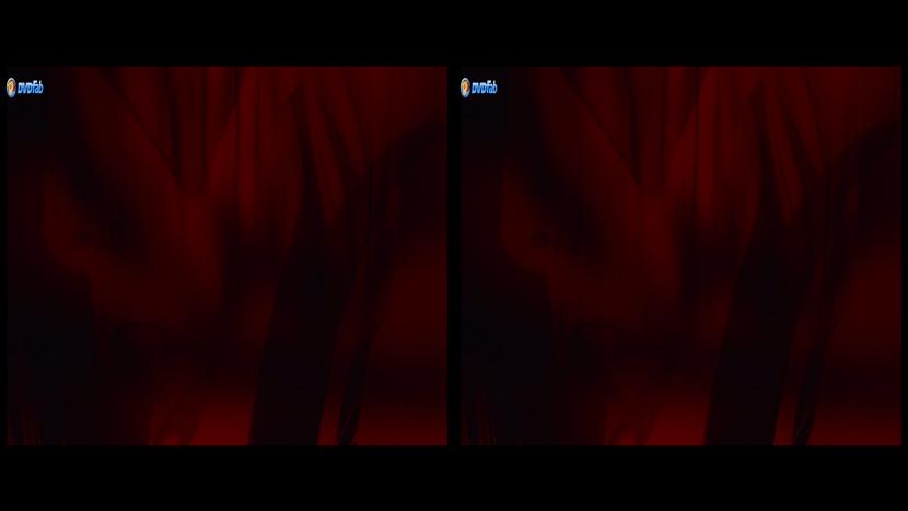

    For some reason the dvdfab logo wont go away dont know why i have a licence for it.
    It is detecting i am using the 2d to 3d converter option but i am not i am using ripper to convert my files to 3d

          original 3D captain America the winter solider disk saved on my hard drive what is strange it is detecting i am using 2d to 3d converter which i dont have a license for but i have a license for the 3d plus which you can see i am using buy the screnshot.
          I want to rip it to 3D

              Here is a bit more info
              6m 24.40s: UILog:OnMsgToolbar_Start
              6m 24.40s: UILog:Msg Start : ready start
              6m 24.41s: UILog:Msg Start : start test run work
              6m 24.43s: UILog:Msg Start : run work
              6m 24.45s: UILog:Run current Work.
              6m 24.78s: UILog:Begin work Converter.
              6m 24.79s: UILog:Begin work copy or converter.
              6m 24.79s: Start check Blu-ray Ripper (3D Plus) register status.
              6m 24.80s: Use 2D to 3D mode, and this product is: Enable
              6m 24.82s: End check Blu-ray Ripper (3D Plus) register status: Enable
              6m 24.82s: UILog:start running at thread.
              6m 24.83s: UILog:return flag at start running at thread ok.
              6m 24.85s: OPList at BD Converter : (4113.2),(4352.2),(4608.8)
              6m 24.86s: Blu-ray Converter (3D Plus) check watermark flag: 0
              6m 24.86s: Product 2D to 3D Converter watermark flag: 1
              6m 26.22s: ------------------ convert work begin(1/1) ------------------
              6m 26.22s: start process(1/1)

                Justin, a suggestion from the Beijing staff: Install DVDFab Virtual Drive and mount the .miniso file. Then open the miniso as the Source for Ripper in DVDFab.
                This should prevent the watermark.
                  Thanks will try that is this a bug in this version
