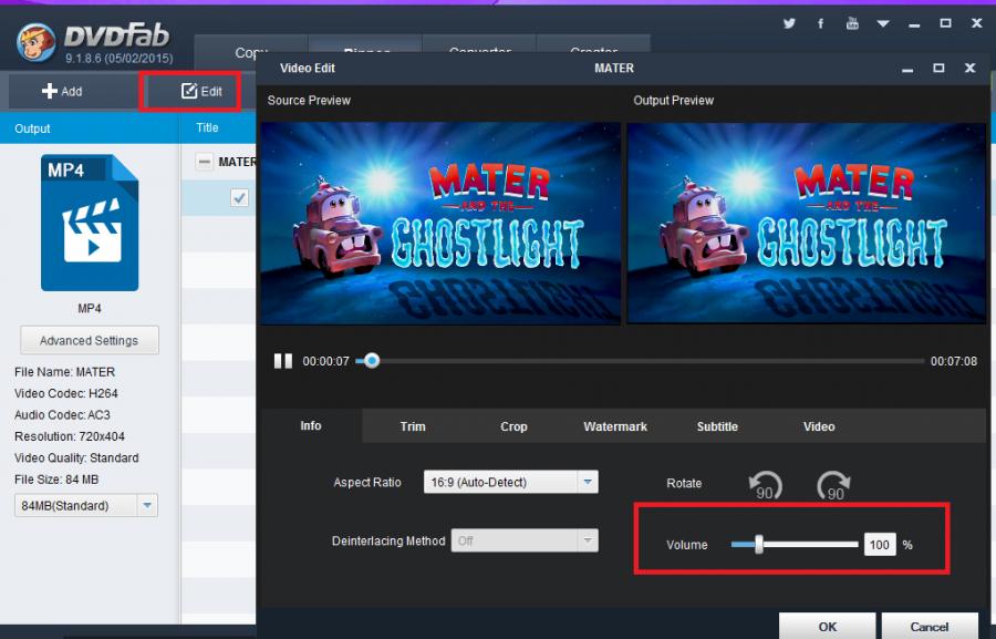

    1) It seems like my rips come out with a lot lower sound level than the original uncompressed iso. Am I doing something wrong?
    2) I've been using "High Quality" as a standard but I've noticed that when DVDFab scans the original iso it varies on what it selects whether it be Normal, High quality or customized. Does DVDFab scan for the best optimized settings to get the smallest file size or should I continue selecting High Quality for each file?
    When making your mp4, after selecting the source, click "EDIT" and you can increase the volume of the mp4. See attached:
      bp123
      In addition to the suggestion that 90312 provided, I would point out that when set for audio copy, DVDFab makes no changes to the audio stream itself, so if audiocopy rips play back with less volume, it is most likely something in your playback device, perhaps a setting or the way the different decoder chipsets work. I have noticed the same thing in playing back mp4s and I have switched to using AAC audio with the volume set to about 130%. The volume setting may be in a different place in the version of DVDFab that you are using, I would recommend an update to the current version.
        Also the volume adjustment does not function if audio copy is selected.
          Must be the decoders as you mentioned because I'm playing it back from the same computer that ripped it. Thats annoying! lol
          I've seen the volume level adjustment tool there I just thought I'd ask before I started tweaking settings within the movies. Unfortunately that means I'm gonna have to do a few test runs and redo the 300 movies I already did! #FirstWorldProblems
