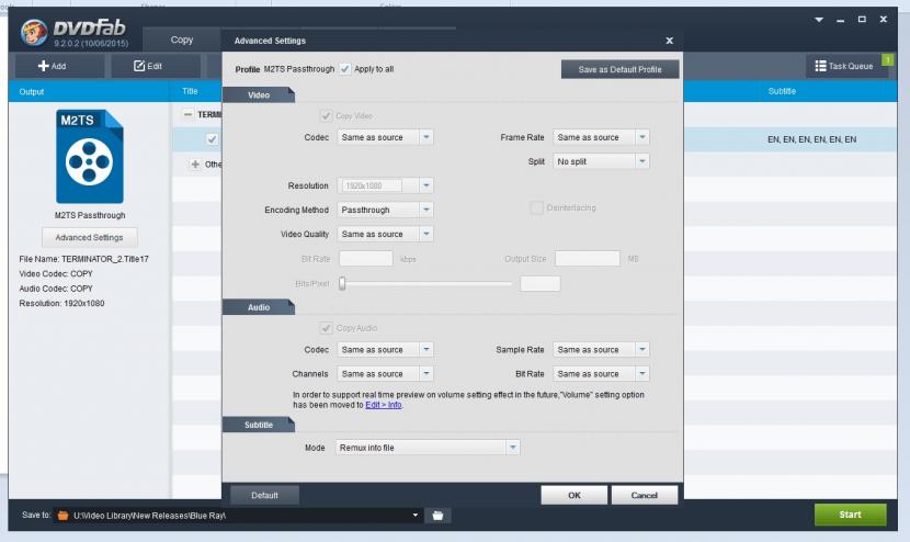

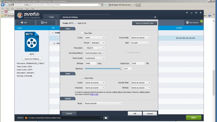

              Sorry for all of the posts but I wanted to be clear on the problem. It isn't when I use passthrough. I agree that is fine. I've attached screenshots to show the settings when it is bad and when the lip sync is good.
                jbinkley
                Thanks for adding the captures. The problem occurs when you are re-encoding the video but not the audio. m2ts passthrough just copies the original files from the Source (no decode or encode) and the sync is also good when encoding both video and audio.
