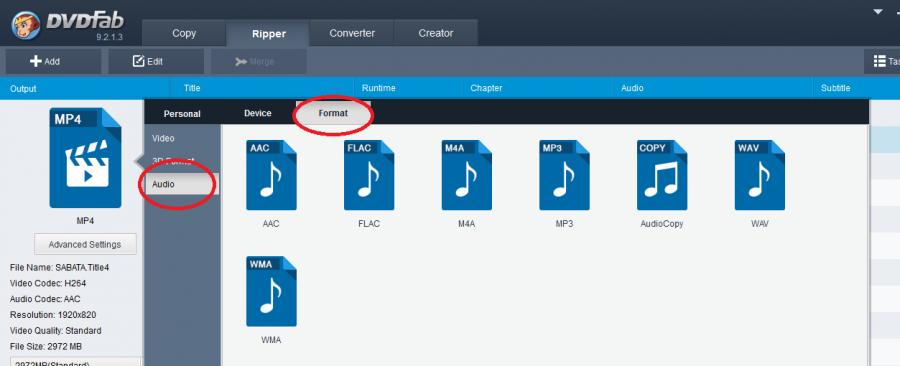

    I choose an audio stream to rip, which is PCM 24/96 stereo. Select AudioCopy as the type of audio I want because I want the original 24/96 resolution. But why do my ripped files end up as being RAW files which I cannot open?
    Ripping to WAV files is not a problem only that Blu-ray Ripper will down size it to 16/48 stereo.

        Andy, please clarify that you are using the controls shown in the capture to extract the audio.
          Yes, I am using the controls as shown in the capture
